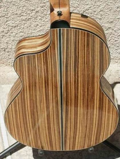

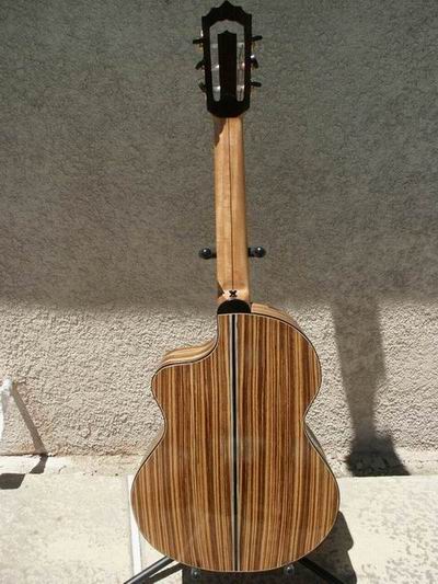

I agree Zebrawood is very beautiful but very porus! I fill with CA and it does a good job. I think it sounds very similiar to IR. Here's a picture of an early work of mine, a classical cutaway.
PostPosted: Wed Apr 13, 2005 6:56 am
Posts: 299
A Closer view.
Ed.

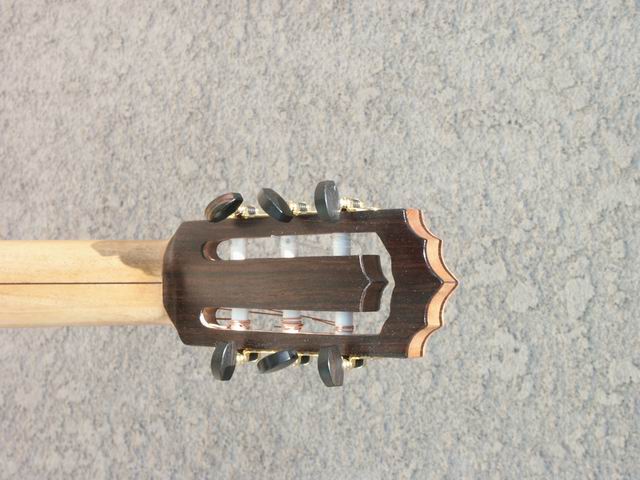

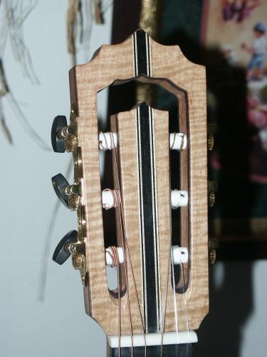

Great looking guitar Ed. Do you have a closeup of the headstock?

Posts: 299
here's one of the headstock.
PostPosted: Wed Apr 13, 2005 7:54 am
Posts: 299
back of headstock.

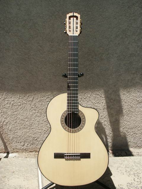

PostPosted: Wed Apr 13, 2005 8:01 am
Posts: 299
Front. Again this was an early work. I still use the same headstock but it's executed better espeacially in the area of string ramps and finish. The guitar was my 3rd guitar and first attempt at a cutaway. The Top is Englemann and the whole guitar is frenched polished and it has Tap Plates. The guitar is 650mm scale acoustic\electric with Fishman active matrix under saddle pickup. The guitar is also lattice braced.

Ed--that's a striking guitar. By the way, you should be getting that info on Smallman in a day or two. I'd say "post haste", but that's an oxymoron.
Do you get any flex with that pierced headstock?
PostPosted: Wed Apr 13, 2005 4:12 pm
Posts: 299
Steve, Thanks again for the information. As to flex in the headstock, none at all. The oldest guitar I made using that design is 6 years old and it's still holding up great. I laminate my necks and usually put a decorative headplate on both front and back, I think this makes it stronger, like an I-beam.
